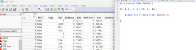

For years, I have a script that I use about 1x a week. Strangely enough, today, it suddenly returned an error message:
Argument to Type in access or evaluation of ‘Data Type’, Data Type Numeric ) /*###*/
For(i = 18, i < 103, i = i + 2,
	Column(i) << Data Type(Numeric)
I think it's just last week that I've updated to JMP v17.2. Is there a change in the new version? Needless to say, that in the original columns, there could be characters present (such as  "n/a" etc). But that was always the case - and that's why I need to convert format to numeric.
Thanks for advise

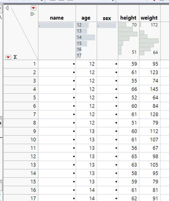

Names Default To Here(1);
open("$SAMPLE_DATA/Big Class.jmp");
For(i = 1, i <= N Cols(dt), i++,
	Column(i) << Data Type(Numeric);
Based on Scripting Index the argument should be a string (<< Data Type("Numeric") but it seems to work fine (and JMP uses non-string versions when it generates the script with << set data type).

This example works in 17.2.

This is utterly bizarre. Would you be willing to try the script in the attached? It doesn't work in my version (but should, in my eyes?!?)

Strange, indeed.  I ran the script on the test table using JMP 17.2.0 and had no problem.
