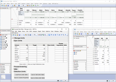

Hi Community,
Example from this table
I have table that produce column Name of 5 people. All people have specific spec limit which is row HighL & LowL. Some of them never have spec limit either HighL & LowL or both. But i want to put spec limit on that people that have a high & low limit. Imaging that i have total 100 people that have randomly spec limit.
Could someone help me write a script that can automatically set the spec limit from row number 3 & 4 which is HighL & LowL in all column Name. Just put only spec limit Upper & Lower don't need a Target.
Pleaseeeeee..... i can't do manually on this method is too many of them.

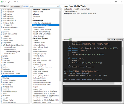

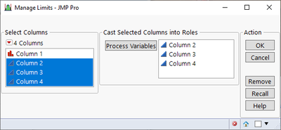

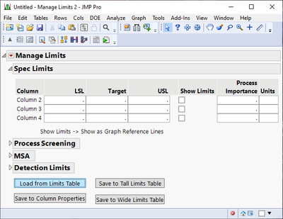

If you rename your HighL to USL and LowL to LSL you might be able to already do this with Manage Spec Limits.
Load from Limits Table
Refer to same table
if you wish to see them, from red triangle add show limits to all
finally press Save to Column properties
(My Column 2 didn't get spec limits added as it has LSL which is higher than USL)

On my table sir, i have some name people that don't need to put spec limit on USL/LSL or both. Refer to my picture below.
Do you know how to disable or delete all those number in single key or script that can only put the spec limit on number except LSL (-9.9999e+100) USL(9.9999e+100)
Also can you write me a script that can rename all those HighL & LowL into USL & LSL and put all the spec limit automatically in all those name except the infinity spec.
I will be an grateful on this help,

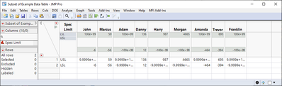

If you cannot change those values to missing, I would most likely:
  1. Create a subset with HighL and LowL rows and all columns
  2. Use recode to change HighL and LowL to USL and LSL
  3. Use recode to change 9.99e100 values to missing values (or some other method is also fine)
  4. Use the created subset as your limits table
  5. After limits have been set, close the subset
JMP can most likely script most of this for you with Enhanced Log / Workflow builder. It might not be able to script the process of getting limits from the table and then setting them as column properties from Manage Limits, but Scripting Index does have examples of that. Here is example for Load from Limits Table

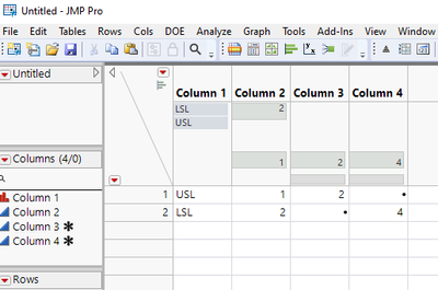

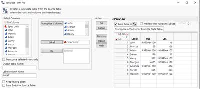

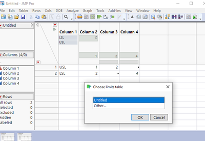

One fairly simple option is when you have your subset with LSL and USL rows
Transpose this (much easier to input columns here with a script than to recode if I remember correctly)
Rename Label column to Variable, recode your LSL and USL columns
and use this table as your spec table
