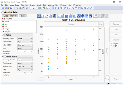

How do I make Combo Chart in Graph Builder?
I know how to create secondary axis in Graph builder, but I don't know how to make it another chart type without affecting the main y axis.
Thank you

What type of secondary axis do you have in graph builder? If it is something like this
right click on the graph and change plot type for other axis
