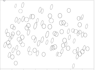

I'm triying to put a column which contains pictures as marker for a graphic.
This is what i want :
When I make this graphic get the script and copy it in my script then play it I got this :
In fact I have to select this :
 which "is define a column as shape" and it works. ( yes i'm french ).

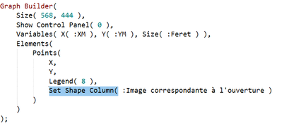

But i would like to have a script which make it.
This script should be good :
but it doesn't work.

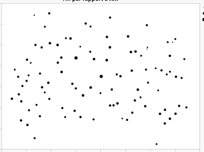

And a second question is about marker size, i would like to decide how many size i want because JMP selection is too big when i use continuous variable as size.

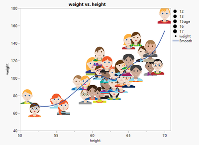

  I tried it out using the Big Class Families.jmp file in the sample directory. I got something like the following, which is basically what you want:
  This is the JSL code saved from the Graph Builder platform I used to generate the above graph.

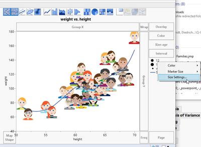

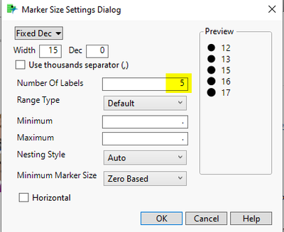

  I think you have to first manually set the image column as well as the number of levels (I'm using age as an ORDINAL size variable). You might need to change your :Feret size column to ordinal instead of continuous as this might allow for more flexibility when defining the number of levels.
  If you right click on the size options and select size settings...
  You can define the number of levels (or labels) to show on the legend.
  When I save and run the above JSL script, it works as expected and reproduces the graph that I had manually created in order to generate the script to begin with.
