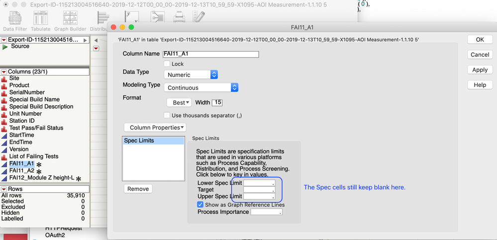

Hi All,
I imported csv files into JMP to get data table (assigned as dt0) and spec table (assigned as dt1) respectively. I wonder to get the spec in spec table (dt0) and set Spec Limits of columns in data table (dt0).
The issue I found that the specs can not be set successfully:
Here are my codes:

For(i=13, i<=N Cols(dt0), i++,
Column(dt0,i)<<Data Type(Numeric);
Column(dt0,i)<<Modeling Type("Continuous");
For(i=13, i<=N Cols(dt1), i++,
Column(dt1,i)<<Data Type(Numeric);
Column(dt1,i)<<Modeling Type("Continuous");
tempUSL=Col Stored Value(dt1, i, 1);           //Assign the spec from dt1 spec table to 'tempUSL' and 'tempLSL'
tempLSL=Col Stored Value(dt1, i, 2);
Eval(
Eval Expr(
Column( dt0,i ) << Set Property(
"Spec Limits",
{LSL( Expr( tempLSL ) ), USL( Expr( tempUSL ) ), Show Limits( 1 )}
Any advice to address this issue? Thanks

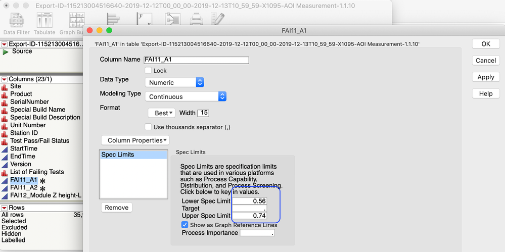

Adam_Xu
Level III
Re: Set Spec Limits of columns with column stored value
If assign a number to 'tempUSL' and 'tempLSL' directly, it could work.
But I need to assign the spec limits from spec table.
	tempUSL=0.74;
	tempLSL=0.56;
	tempTarget=(tempUSL+tempLSL)/2;
	Eval(
		Eval Expr(
				"Spec Limits",
