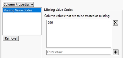

Also if those 999 are already missing data with "random number"? you could also use Missing Value Codes column property to hide them from analysis:
Set Property("Missing Value Codes", {999})

I did try the ". = "Fail" but it didn't work for me the first time. Is placement in the { } important? I will give it a try again here real soon. BUT, I like the missing value codes property. I will also try that real soon.
