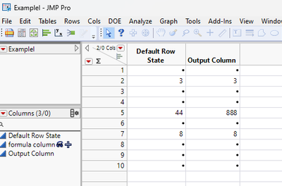

This method for you might work.  Use a hidden column that has a formula that sets the value in a different column.  The column that has the value set remains editable, since it does not contain a column formula.
New Table( "Examplel",
	Add Rows( 10 ),
	New Column( "Default Row State",
		Numeric,
		"Continuous",
		Format( "Best", 12 ),
		Set Values( [., 3, ., ., 44, ., 8, ., ., .] )
	New Column( "formula column",
		Numeric,
		"Continuous",
		Formula(
			If( Is Empty( :Default Row State ) & :Default Row State != :Formula Column,
				:Output Column[Row()] = .,
				:Output Column[Row()] = :Default Row State
			:Formula Column = :Default Row State;
		Hide
	New Column( "Output Column",
		Numeric,
		"Continuous",
		Set Values( [., 3, ., ., 888, ., 8, ., ., .] )

txnelson
Re: Set Editiable rows with formula column
	Add Rows( 10 ),
		Numeric,
		"Continuous",
		Numeric,
		"Continuous",
		Formula(
		Hide
		Numeric,
		"Continuous",
Jim
