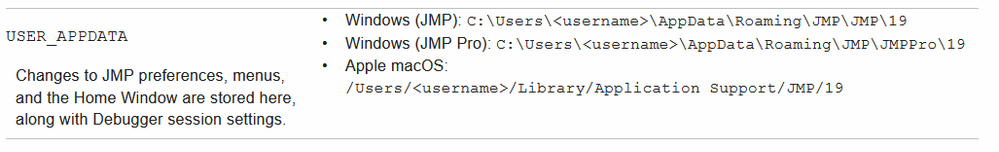

I had to create mapscaler script to fix scaling issues with the JMP maps, and for that I had to figure out where all the map files are. There are two possible locations (I assume this is still true for JMP19) I did something like this (for windows)
Names Default To Here(1);
mapdir1 = Convert File Path("$JMP_HOME/Maps/", windows);
mapdir2 = Convert File Path(Word([1 -3], Get Path Variable("$HOME"), "/") || "/JMP/Maps/", windows);
show(mapdir1, mapdir2);
I also slightly expect this to break at some point
-Jarmo
Re: Semiconductor Toolkit not displaying background maps
I’m using the included JMP path variables that point to both. I just need to figure out why it’s working fine for some and not others.
M
jthi
Could it just be a difference between Mac and Windows for the path variables?  Scripting Guide > Types of Data > Path Variables
-Jarmo
No, the way I’m dealing with it works on both Mac and pc. It also doesn’t explain why it works fine on some PC installs and not others.
