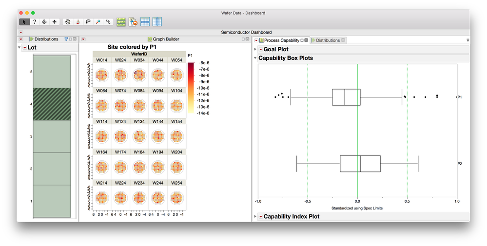

Attached is an example screenshot of a dashboard using the Filter + 1 template from the Dashboard Builder. This dashboard is in summary mode and the three graphs line up in columns. The distribution of 'lot' acts as a selection filter, where selection in the one graph cause a local data filter effect on the Graph Builder graph as well as the two statistical platform outputs from Process Capability and Distribution "downstream".
ExampleDashboardwFilter.png You can arrange the dashboards any way you like -- with graph spanning rows or columns, or with graphs in tabs. For example -- a more complex layout below:ComplexLayoutDashboard.png

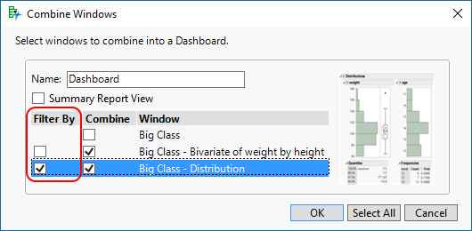

@Daniel_Valente shows how to create grid views and single-level filters in the Dashboard Builder.  You might also consider using Combine Windows to create your initial grid - arrange the windows roughly on the screen and select the menu item Windows > Combine Windows.  The resulting dialog has an option to choose a single report as a filter for the other reports:

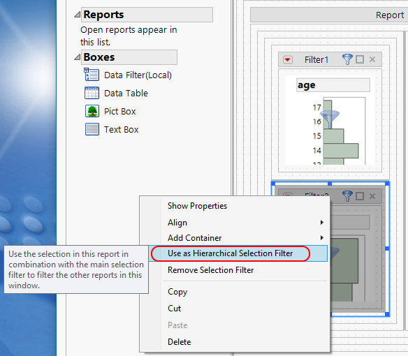

Within the Dashboard Builder, you can also create hierarchical filters similar to what you describe as 'layers'.  Start by selecting a container (in this case Splitter Box) that holds all of the filter reports, right-click, and choose 'Use As Selection Filter".
Next, select a box within that filter to choose the next layer of the filter, right-click, and choose 'Use As Hierarchical Selection Filter'.
You do have to arrange the reports in a manner that supports the layering that you want to accomplish.  Similar examples are also presented in the Using Selection Filters in JMP 12.
