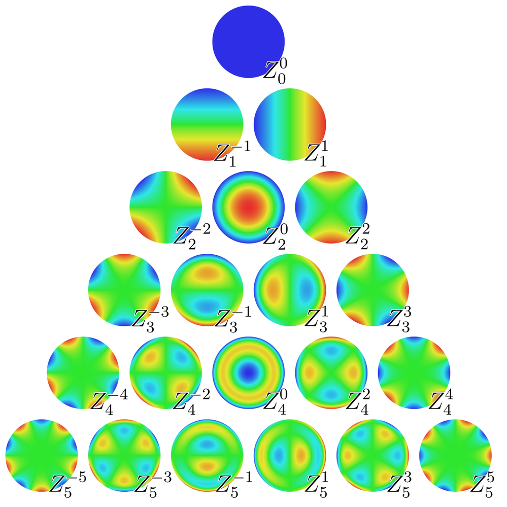

Suppose these are the patterns of variation that you would like to detect in your tabletops:
image.pngHow would you sample to detect these patterns?  Hint: you may need more than 5 sites!  If you can't afford more than 5, some trade-offs will need to be made.
I think this is the representation risk that Peter and Byron are talking about...this is the domain expertise that is required.  What are you trying to do with your sample?
By the way, this is an image of different Zernicke polynomials!
