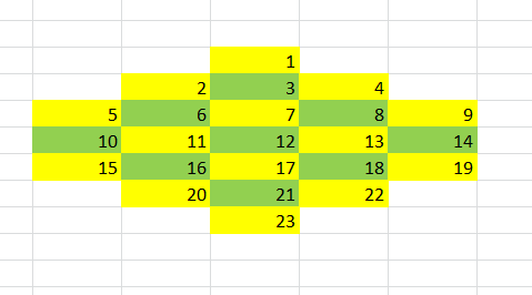

Hi Stephen,
Above is an example of my measurement location. If I were to select only 5 location to measure, how do I select which 5 location measurement that gives the best statistical representation of the all 23 measurement location. Is there a way to find out ?

Re: Selecting the correct sample size
Are all locations considered equal? Is number 12 (the centre) special in any way? One sampling scheme would be sampling at random from the different 'zones'. Are the locations rotatable (i.e 1 = 9 = 23)? You can run simulations based on historic data to compare how well any sampling scheme estimates the 'true' value if all locations are considered.
