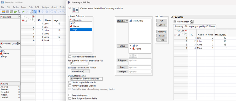

How to select duplicate rows with conditions?
I have a table with duplicate IDs, but some of the values from other rows are missing. What I need to do is to delete the duplicate row with missing information and retain the complete one.
For example:
ID Name Age
1 Jane 12
1 Jane
2 John 16
3 Anna
3 Anna 15
4 Mark
Rows 3, 5 should be deleted. I know "Select duplicate rows( Match( :Col1, :Col2 ) );" but I'm not sure how to specify to select and delete those with blank :Age. Please help

Re: Selecting duplicates with complete row values
If you run the Summary Platform as I specified, it will result in removing the specified rows.  Below is your sample data table, and the preview of what the results of running the Summary Platform will produce
The data you want removed has been removed.

txnelson
If there is always only 1 record for each person that has a non missing value for age then a simple
     Tables=>Summary
where you group on name and specify to calculate the mean of age.
Jim
UserID16644
Level V
But I need to delete the blank duplicates
txnelson
Jim
UserID16644
Level V
Got it! Big thanks
