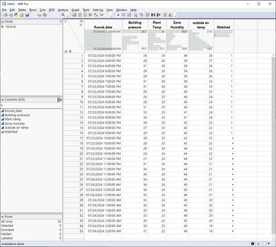

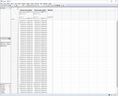

I have two data tables named, HVAC and Events. I want to match date/times in HVAC based on start time and end times of the Events table and mark the matching rows in HVAC table with 1.
I have script that runs but does not populate the "Matched" column and I am not quite sure why.

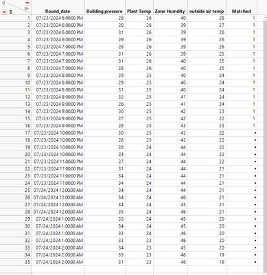

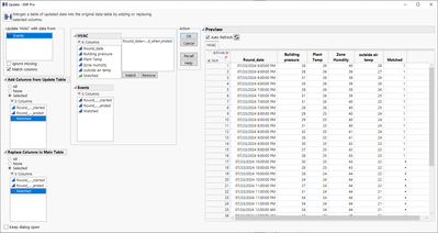

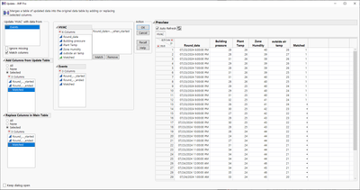

If this is how your data looks like (even hours) and the matches are defined like in your script, you should be able to do this with double join/update. Add Matched column to your Events table
and then first join using Round_date and Round_when_started
Then for second join use Round_date and round_when_ended.
And of course you can use something like Jim did demonstrate.

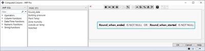

I think you shouldn't need JMP Pro for what I did. I just used Tables > Update (should be available with standard JMP) twice but you could also do it with a single query using Query Builder

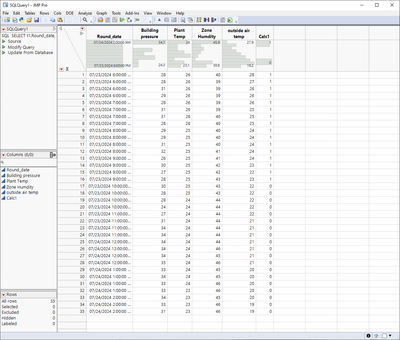

SELECT t1.Round_date, t1."Building pressure", t1."Plant Temp", t1."Zone Humdity",
t1."outside air temp", t3.Round_when_ended IS NOT NULL OR t2.Round_when_started IS NOT NULL AS Calc1, t3.Round_when_ended IS NOT NULL OR t2.Round_when_started IS NOT NULL AS "Calc1 2"
FROM HVAC t1
LEFT OUTER JOIN Events t3
ON ( t1.Round_date = t3.Round_when_ended )
LEFT OUTER JOIN Events t2
ON ( t1.Round_date = t2.Round_when_started );
And JMP's query builder script is something like this
