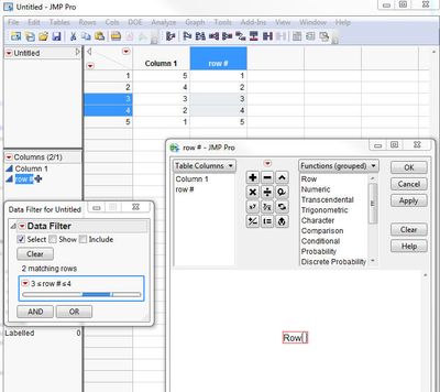

You can add another column, and add a formula with the function "row()" - then you can use the Data Filter in the Rows menu item to select the rows you want. See screenshot below
