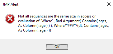

Hi @Jeff_Perkinson , is there a similar trick which can be used together with the new Where?
dt=open("$SAMPLE_DATA\Big Class.jmp");
ages={13, 14, 15};
dt<<select where(contains(ages, :age));
//how to make this work?
where(dt, contains(ages, :age));
where(dt, contains(ages, :age[]));
where(dt, contains(ages, As Column(:age)))
