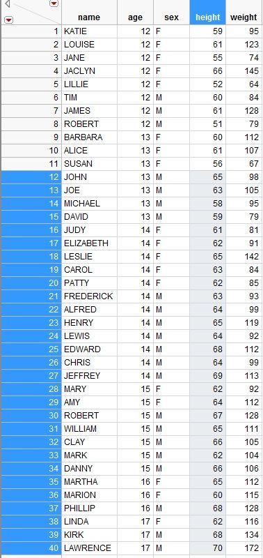

Hi Jim, instead of hand picking what cells to select, can I pick a range let's say 2-19?
Thanks
SamH
Level III
Re: Select a group of cells in a column
or row 12 thru 40 in column "height"
SamH
Level III

Jim, I am trying to automate this process, because the files I am dealing with could have 1k-2k rows. if I have to specify every row, my code will be so many pages.
SamH
Level III
Jim, I figured it out, here is the code it works.
Names Default To Here( 1 );
L = N Rows( dt ); // number of rows
For( i = 3, i <= L, i++,
dt << Select Rows( i, L );
dt << Go To( :Height );
Wait( 2 );
dt << Select Matching Cells();
