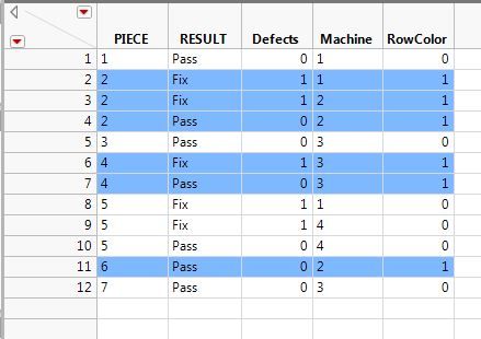

@ron_horne, Thanks for trying to help me out. However, I feel that I am not being clear.  What I'm looking for is the following based on the value in :RowColor
I want the whole row for RowColor = 1 to be light blue/Color(59)

WendyLou315
Level III
Re: Select Cell Color for Row Based on one Cell's Value
Thank you @pmroz!!! That is what I had missed!  All the other "For" statements I attempted previously didn't get me there.  Now I see where I went wrong.
