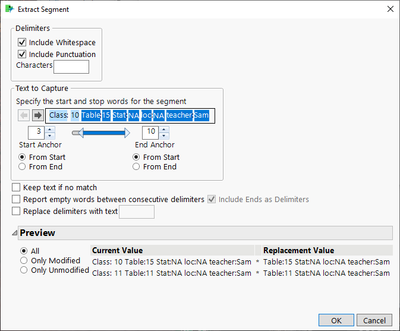

Depending on your string format, you could maybe use Recode (note that Keep text if no match isn't checked)
or script using For Each Row. If you use For Each Row, you have many different options for parsing the string and how to store your results, below is another example

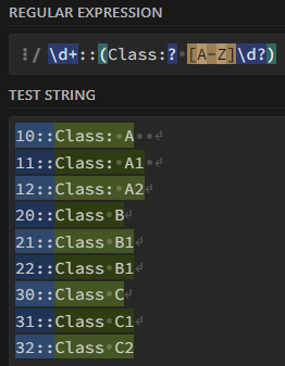

I would like to group the list into subgroups based on only and only the first digit. I tried to use regex Anchors to do so. However, instead of matching only the first digit, it matches the first and whatever digits comes after.  Any guidance is appreciated.
jthi
Re: Searching every cell in one column to find a specific content
Do you mean the Class B1 part? You can modify the regex by adding \d? inside brackets (https://regex101.com/r/Yfh6pZ/1). \d will match a digit and ? will match the token before it ZERO or ONE times. If you don't want to capture groups which have no digits, leave out ? or replace it with {1}
