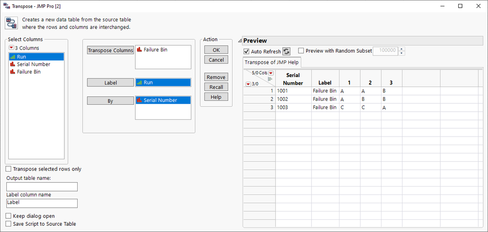

I'm not sure if you can get that type of result using Tabulate (use the Tabulate platform to interactively construct summary tables, or pivot tables, of descriptive...), but you can create similar table using Split or Transpose
and then rename those 1 2 3 to Run1, Run2, Run3.

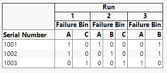

With tabulate you will end up with something like
