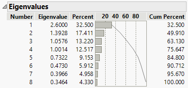

  I am trying to write some JSL code that takes data from a data table and graphically displays it for the user to choose from for further analysis. What I'd like to get is something like a mix between the Eigenvalue report from the PCA platform and the Effect Summary report from the Fit Model Platform. I'd like the visual to look like the PCA report, but the functionality (i.e. being able to select a row) of the Effect Summary report.
PCA Eigenvalue report (how I want it to look):

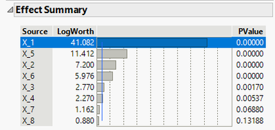

Fit Model Effect Summary report (the functionality I'd like). In this platform one can select a row in the List Box() and choose to "remove" or "add". I don't want to remove or add, but I do want the user to be able to select the row (from the above output):

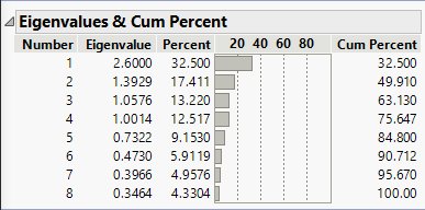

With the commented out sections I get the following output from the code (no row is selectable, though):

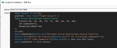

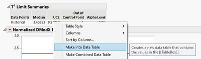

Sometimes it might be enough to use Make into data table (depending on platform and if you are using By variable):
and then checking from the resulting table the table script:
Sometimes that gives quite quick way to get references to correct Display Boxes.

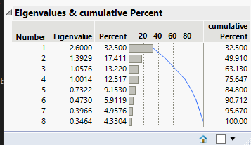

For item 1:
I would guess there is some other / better way to do this, but I found << Lower and << Upper (requires Lower to be specified) messages. With << Lower you could get first values from the Cumulative Column and then set those to Plot Col Box with Lower
pcb << Lower(ncb << get as matrix);
With your code it would look something like this (add references and use those):
View more...

  Thanks again for your quick feedback and help. Yes, the <<Lower worked fine. There perhaps might be a better way to do it, but this does exactly what I want. So, technically the two questions to my original post are solved, thank you!
