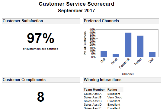

I scripted a simple 2x2 scorecard (see attached JSL):
When I saved the journal to PDF and printed it, the display boxes had different widths:
  • OutlineBox - 3"
  • GraphBox - 2.88"
Is there a way to make the display boxes all the same width (e.g., 3") ?

You can use a LineupBox to organize DisplayBoxes in a grid where columns all have the same width. This would be instead of using V and H List Boxes as shown below.
win = New Window( "Customer Service Scorecard",
	Text Box(
		<<setFontSize( 16 ),
		<<SetFontStyle( "Bold" ),
		<<setWrap( 800 ),
		<<SetWidth( 600 ),
		<<JustifyText( "center" )
	Text Box( "September 2017", <<setFontSize( 14 ), <<SetFontStyle( "Bold" ), <<setWrap( 800 ), <<SetWidth( 600 ), <<JustifyText( "center" ) ),
	Text Box( " " ),
	Lineup Box( N Col( 2 ),
		Outline Box( "Customer Satisfaction",
			Text Box( " " ),
			Text Box( "97%", <<setFontSize( 40 ), <<SetFontStyle( "Bold" ), <<SetWidth( 300 ), <<JustifyText( "center" ) ),
			Text Box( "of customers are satisfied", <<setFontSize( 9 ), <<SetWidth( 300 ), <<JustifyText( "center" ) )
		dt1 << GraphBuilder(
			Size( 300, 200 ),
			ShowControlPanel( 0 ),
			ShowLegend( 0 ),
			Variables( X( :Channel ), Y( :Pct of Customers ) ),
			Elements( Bar( X, Y, Legend( 6 ) ) ),
			SendToReport(
				Dispatch( {}, "Graph Builder", OutlineBox, {Set Title( "Preferred Channels" )} ),
				Dispatch( {}, "Channel", ScaleBox, {Labe Row( LabelOrientation( "Angled" ) )} ),
				Dispatch( {}, "graph title", TextEditBox, {SetText( "" )} ),
				Dispatch( {}, "400", LegendBox, {SetTitle( "" )} )
		Outline Box( "Customer Compliments",
			Text Box( " " ),
			Text Box( "8", <<setFontSize( 40 ), <<SetFontStyle( "Bold" ), <<SetWidth( 300 ), <<JustifyText( "center" ) )
		Outline Box( "Winning Interactions", Text Box( " ", <<SetWidth( 300 ) ), Data Table Box( dt2 ) )

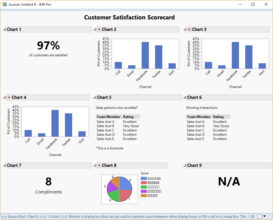

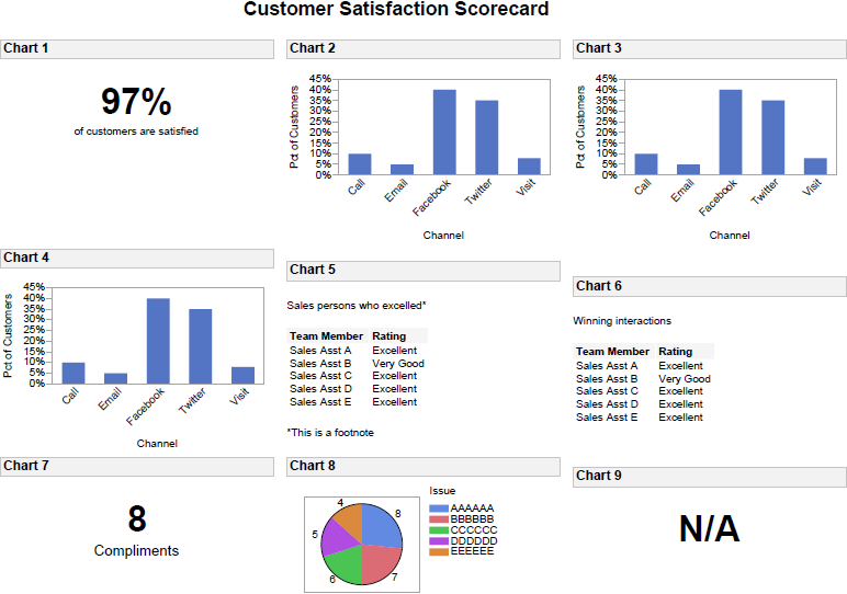

LineupBox did work for my example of a 2x2 grid of 4 charts.
However, I get weird results (vertically) when I use LineupBox for a 3x3 grid of assorted 9 charts:
Any suggestions for the attached code (Scorecard2.jsl) ?
pmroz
Re: Scripting display box widths: OutlineBox & GraphBox
I suspect that JMP is centering each object vertically on the page, hence the apparent misalignment.  I don't know if there's a way to set the object to appear at the top of it's grid.

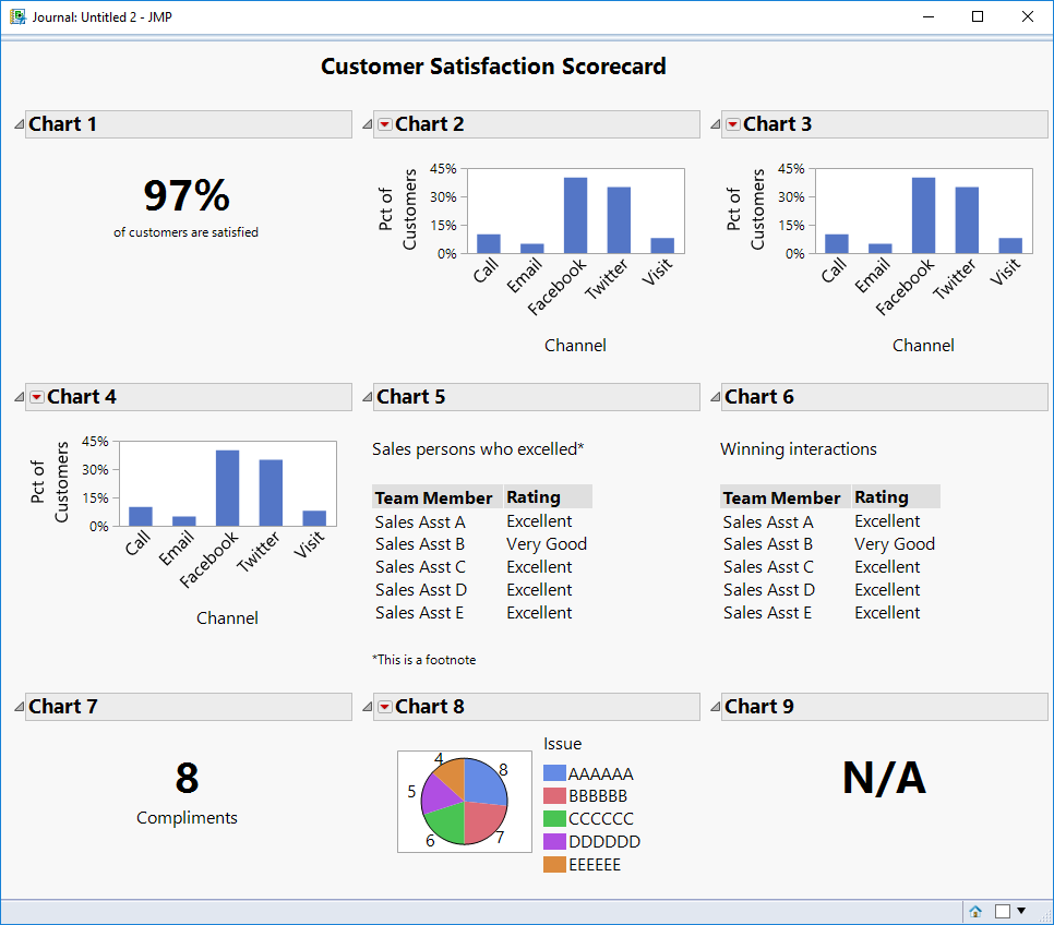

vince_faller
Super User (Alumni)
if you put each of those outline boxes in a Vlistbox() with a spacerbox() underneath it.  It will line up.
Vince Faller - Predictum
@vince_faller, I was thinking of same thing yesterday with using the SpacerBox() to force the DisplayBoxes to be top aligned.
The one improvement I might suggest is to use a LineupBox of 1 column instead of a V List Box so that the width of the items are inherited. See attached.
Justin
ian_jmp
Level X
Perhaps I missed something, but maybe you can make rows with 'HListBox()', then use the 'Vertical Alignment(center)' message?
ian_jmp
Level X
Sorry. Please disregard the post above. Now I see the columns don't line up . . .
vince_faller
Super User (Alumni)
Didn't realize it inherited. Awesome.
