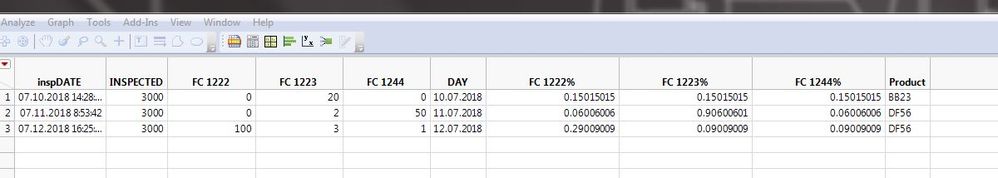

I am scripting a dashboard with graph builder in it. I want to add a column switcher that should use a variable as a column list, due to changing columns. For some reason this doesn't work, only first column in a list will show. Column list is created like this:
col_list3 = dt << get column names(Numeric);
for (i = nitems(col_list3), i > 0, i--,
if (!contains(col_list3[i], "%"),
remove from(col_list3, i);
But when I try to use col_list3 in the Column Switcher embedded in dasboard script, it doesn't work.
Column Switcher(
:FC 1244%,
{col_list3}
I have tried to use eval ect., but no success. What am I missing, any Ideas? For some reason I can't add any files to this post so whole script pasted below and a image of my example data table.

The issue you are having, is that when you specify
Column Switcher(
:FC 1244%,
{col_list3}
you are placing col_list3 inside a set of {}.  But since col_list3 has been specified as a list, it already has the {} in the list.  So what JMP is seeing is a list within a list
Here is a simple script to illustrate how to code what you want
Names Default To Here( 1 );
dt = Open( "$SAMPLE_DATA/semiconductor capability.jmp" );
col_list3 = dt << get column names( Numeric );
For( i = N Items( col_list3 ), i > 0, i--,
	If( !Contains( col_list3[i], "PN" ),
		Remove From( col_list3, i )
Graph Builder(
	Size( 534, 572 ),
	Show Control Panel( 0 ),
	Variables( X( :PNP1 ), Y( :NPN1 ) ),
	Elements( Points( X, Y, Legend( 3 ) ), Smoother( X, Y, Legend( 4 ) ) ),
	Column Switcher( :NPN1, col_list3 )
Jim
