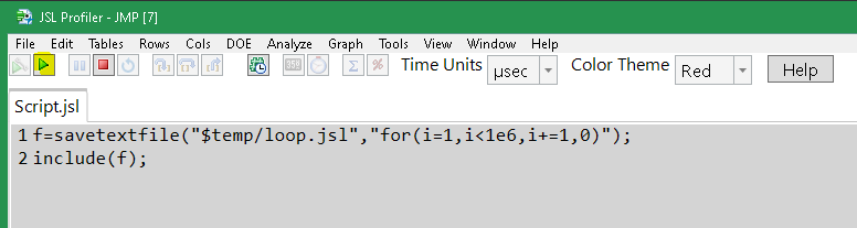

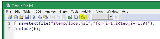

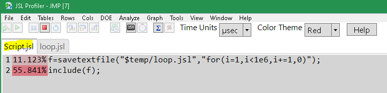

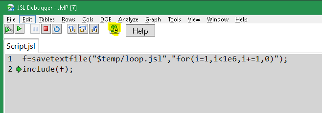

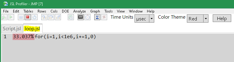

If you want to use the JSL profiler, don't do the 3 hour run for your first profiling experience.Try a small program, using an include, and make sure you play with these buttons:
Something in the toolboxSomething in the toolbox
A new window opens, the clock is for timing JSL.A new window opens, the clock is for timing JSL.
The tooltip for the icon says "run profiler".The tooltip for the icon says "run profiler".
you might be able to use the blue pause button or wait for it to end, then examine the hot spots:
tabs for sourcestabs for sourcestabs for sourcestabs for sources
