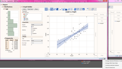

If you use the combine selected windows checkbox (Bottom right) on the graphs you want, it can create an application that you can save the script from.

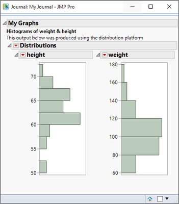

To create a journal you create a new window with the <<Journal message.  From then on you can use standard scripting of display boxes to control content of the journal, for example:
dt = Open("$SAMPLE_DATA\Big Class.jmp");
// create a journal with an outline to contain the graph
nw = New Window("My Journal", <<Journal,
    ob = Outline Box("My Graphs",
        Text Box("<b>Histograms of weight & height</b>", <<Markup(1))
// create a graph
content = V List Box(
    Text Box("This output below was produced using the distribution platform"),
    Distribution(
        Continuous Distribution( Column( :height ) ),
        Continuous Distribution( Column( :weight ) ),
        Histograms Only
// add graph to outline box within the journal
ob << Append(content);
-Dave
