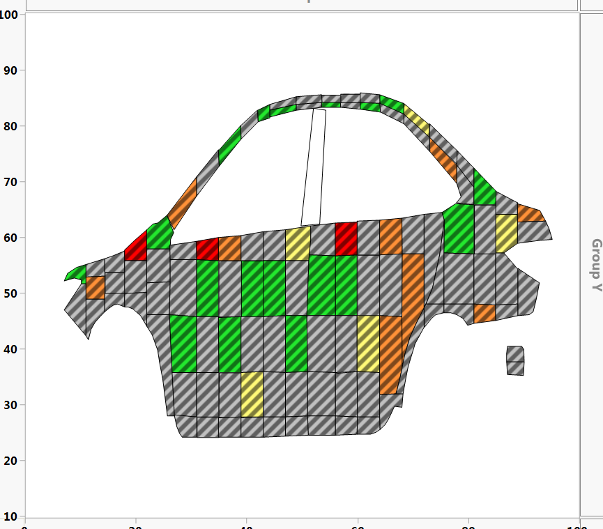

I have created a custom map to graph measurement locations on a vehicle to give a visual representation of the process throughout the vehicle. As you can see below. I would like to be able to select all the data represented in the graph builder below and pull it into a new datatable using script Does anyone know how to select data in graph builder using script?

My data table has points for the whole vehicle and the map in the above example is just points on the left side of the vehicle. I would like to script to be able to highlight just the points in that map to analyze the data in for detail for that specific side.
Just realized that I could have a column describing its location and pull the data out by selecting matching.

apparently you are using different maps for different parts of the car.  If this is the case, you can read the data from the map, and it will tell you what parts are displayable from that map, and then select all of the points in your measurement data table that have those parts.
