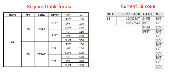

Hi All,
i want to produce a summary table as shown on the left. but the JSL code (attached) have produced result as on the right.

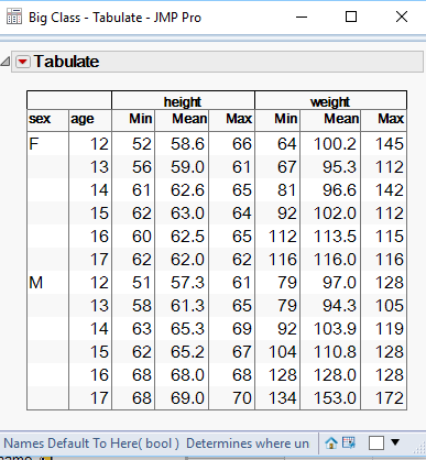

You need to use the Tabulate Platform to generate the output you want
     Analyze==>Tabulate
Tabulate(
	Show Control Panel( 0 ),
	Add Table(
		Column Table(
			Analysis Columns( :height, :weight ),
			Statistics( Min, Mean, Max )
		Row Table( Grouping Columns( :sex, :age ) )

appreciate your reply. But looks like tabulate can not meet the requirement. below are the differences.
1. tabulate can not be copied and paste in excel or in ppt.
2. it changes the order. e.g F comes first than M even if M is first in the original table.
3. it still have all the rows in every column.
this is not what i am looking for.

I find your responses to be incorrect.  I generated this very simple Tabulate:

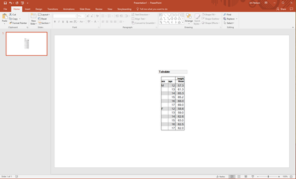

1. Here are the results of copying the above to Excel and ppt

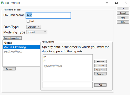

2. The default ordering of the Sex column in my example, is "F" followed by "M", however, if you use the Value Ordering column property, you can change the order to whatever you want
The ordering can also be set to "Row Order Levels", which would order the values based upon the order the data are first found in the data table.
3. And as can be seen in both the excel and powerpoint the Row Values for the column Sex are not repeated.

Ok, I will take back comments 1 and 2. i will try again to copy paste. i must have been doing something wrong.
how about the comment 3. same value rows are not merged in column "sex".
my end goal is to generate the score card using jsl and have same value columns merged.
currently i am  following 2 step method:
1. generating score card using JSL.
2. save in .xlsx using JSL
3. using VBA to merge the same value columns as described on this link.(https://www.extendoffice.com/documents/excel/1138-excel-merge-same-value.html)
it will be great help if tabulate can do the same thing and maintain the merged cells even after pasting into excel or ppt.
