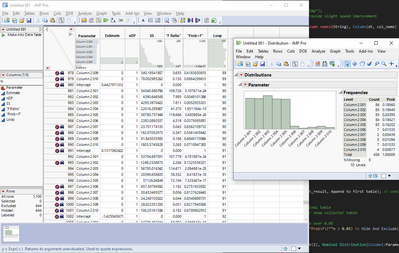

This script didn't seem to have no need for Wait(0) at least on my setup (fast PC, Windows 10 and JMP16.2). For me it seems like the formula values did get re-evaluated
Results:
Scripting index for Wait(), clicking Topic Help sometimes provides more info (in case of Wait() it does)
JMP Help - Wait(n) "Specifying Wait(0) enables one cycle of message processing."
-Jarmo

dale_lehman
Level VII
Re: Script question for Rerun Formulas
Thank you, this is perfect.  And thank you for being patient with me.  Also, the help on Wait() is in help but not the scripting index, as you say.
