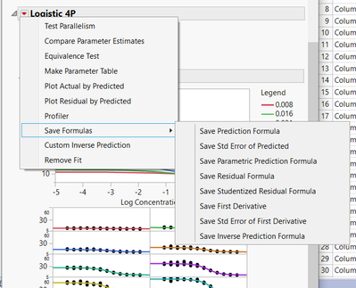

Using JMP16. Trying to write a script to automate a workflow for 4PL regression analysis.
Please see my screen shot below. Under the Logistic 4P red triangle, when any of the operation listed is being executed, eg "Make Parameter Table" or "save fomula", there is no script recorded in the log. How can I find the scripts for the operations?
Thanks

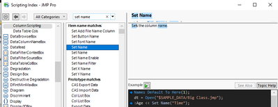

jthi
Re: Finding script logs during 4PL analysis
Scripting Index will help here also.
so you will either need to know the original name of column or you can also use index:
Names Default To Here(1);
Column(dt, 1) << Set Name("Test")
-Jarmo

GroupSquareWolf
Level III
Found the script in Srcipt Index.
A new question:
How to rename the new column generated by "Save formula" and the new table by "Make parameter table" in the script?
Thanks!
dt= Current data table ();
obj= dt << Fit Curve(
Y( :response ), X( :Log Concentration ), Group( :compounds ), Fit Logistic 4P
obj << (Fit ["Logistic 4P"] <<
Save Parametric Prediction Formula);
obj << Fit ["Logistic 4P"](Make Parameter Table
