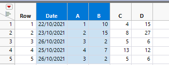

Select columns of interest:

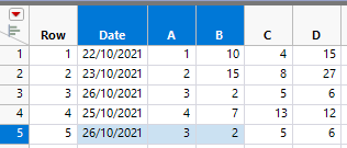

Go to Rows / Row Selection / Select Dublicate Rows:

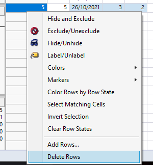

Right click on row number and Delete Rows:
