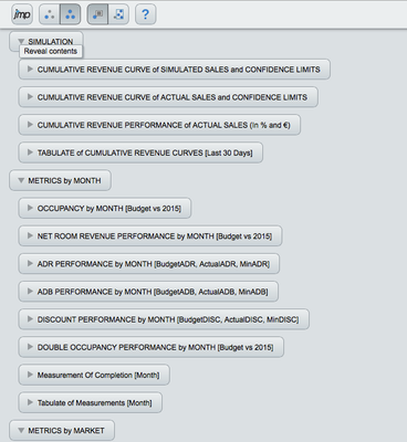

Finally I am using JMP 12, tried hours and hours to put my report into a tabbed format as your guide script but unfortunately I can't "jump".
My reports consist of 53 reports (think them as subtitles) grouped into 8 main titles and the report is growing each day. The output which my skill allows is screenshotted. It is okay but too long for the final user. I would like to put the subtitles into "tabbed titles: SIMULATTION, METRICS by MONTH, METRICS by MARKET .....
I really would appreciate your help!
The first "title" part of the sript is as follows and if you help with trplication it in 3 seperate tabs I guess I will be able to make the rest;
Many many thanks in advance!
