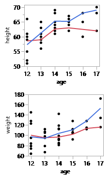

Give me the little finger and I'll take the hand! That worked so good, that now I would like the same thing to work when I have more than one plot in the report, e.g. when I have plotted more than one parameter or by group. Tried experimenting with 'xPath' that I found in the forum, but no success. Syntax is everything.

Send << get xml message to your object reference (rep in this case). Then from log try to see if there is something what you could use to get access to correct outlineboxes
If you have JMP17 I think helpKey is usually quite good bet. You could also possibly use outlinebox names.
After you have those outlinebox references, modify script as needed
Names Default To Here(1);
dt = Fit Group(
	Bivariate(Y(:height), X(:age)),
	Bivariate(Y(:weight), X(:age)),
	<<{Arrange in Rows(1)}
rep = Current Report();
obs = rep << XPath("//OutlineBox[@helpKey = 'Bivariate Report']");
objs = obs << Get Scriptable Object;
// might have to add check if you have correct type of report open
objs << Group By(:Sex);
objs << Fit Each Value;
-Jarmo
