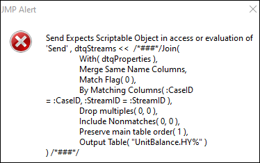

Still having some issue around joining both tables, here is the script I implemented following your post:
// Join both Data Tables
dtJoined = dtqStreams << Join(
	With( dtqProperties ),
	Merge Same Name Columns,
	Match Flag( 0 ),
	By Matching Columns( :CaseID = :CaseID, :StreamID = :StreamID ),
	Drop multiples( 0, 0 ),
	Include Nonmatches( 0, 0 ),
	Preserve main table order( 1 ),
	Output Table( "UnitBalance.HY%" )
But it still gives an error:

Re: Script - Work with Data Table from OBBC query
So here I have to admit that I don't use New SQL Query very often.  Your code looks correct.  Two ideas here, one that you might need to put parentheses around (New SQL Query( ... ) << Run), and another is to include a wait statement to make sure the queries actually evaluate before moving forward.  Try running your code one line at a time, and see if the n row functions returns the number you expect.
//Get data
dtqStreams = (New SQL Query( ... ) << Run);
dtqProperties = (New SQL Query( ... ) << Run);
//Make sure everything evaluates
wait(1);
//check that table contains values
n row( dtqStreams );
dtJoined = dtqStreams << Join( With( dtqProperties ), ... );
// Set column properties
dtJoined:"StreamFeedFlag"n << Add Column Properties( ... );
// Add new columns
dtJoined << New Column( ... );
// Make graphs from your joined data table
dtJoined << Graph Builder( ... );
Thanks for taking the time to look into it. Unfortunately that did not work.
