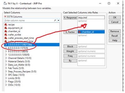

Wondering if this is possible. I have a bunch of columns I've grouped together and want to standardize a script that will send all the columns in a group to the Yresponse. Each instance of this data table will have a variable amount of columns and the names will be changing and not fixed.
I'd love to just say: Send this group to the Yresponse.

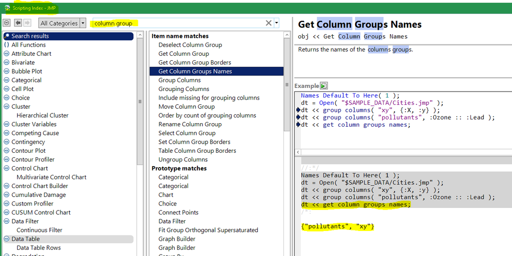

The scripting index shows a function you could use to get the column group names. You could use each of those names to call the get column group method and build a full list to pass to the platform you are running.  Roughly:
// untested
groupnames = dt<<getcolumngroupnames;
biglist={};
for(igroup=1,igroup<=nitems(groupnames),igroup+=1,
   insertinto(biglist, dt<<getcolumngroup( groupnames[igroup] ));
show(biglist);
... X(biglist) ...
scripting indexscripting index
