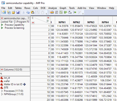

Here is a simple script that creates a new group of columns that begin with the characters "NPN"
names default to here(1);
// Open Data Table: big class.jmp
// → Data Table( "big class" )
dt = Open( "$SAMPLE_DATA/semiconductor capability.jmp" );
colNamesList = dt << get column names(string, continuous);
NPNList = {};
for(i=1,i<=nitems(colNamesList),i++,
	If(contains(colNamesList[i],"NPN")==1,
		insert into(NpNList,colNamesList[i])
dt << group columns("NPNGroup", NPNList);
