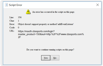

I am trying to open some web pages with the JMP browser either using the Internet Open menu or the Web("link", JMP Window) JSL command.
In either case I am getting script errors similar to the ones below. Is there a setting that is wrong or something in Javascript that needs to be updated?
Trying to open: "mauth.cbssports.com/login?master_product=150" and getting the error:
Discontinuing scripts leaves a page that I can't interact with. Hope someone can help. Thanks!

JMP uses the Internet Explorer ActiveX control in browsers contained within JMP windows. These include the File > Internet Open… and the Web browser display box browsers.
The IE control defaults to using Internet Exploerer version 7 compatibility settings which does not handle many newer HTML/CSS features. This can result in popups such as you're seeing here.  If you control the HTML, you can set the document compatibility mode using a <meta> tag (see below for links).
Usually you do not control the HTML source so for those cases, there is another fix.  There is a registry key you can set to instruct the IE control to use a newer rendering engine such as IE 9,10, or 11. As of JMP 13, the JMP setup program will set the registry key for IE 11 compatibility mode.
It’s worth noting this registry key will affect all instances of jmp.exe launched no matter the JMP version.

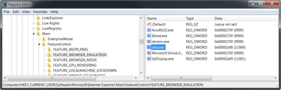

Once there, you can right-click and add a new DWORD (32-bit) value.
Here's the value to use IE 11 capabilities.
Value name: jmp.exe
Value data: 11000
(Set the 'Base' to Decimal)
Once set, relaunch JMP and try again.
