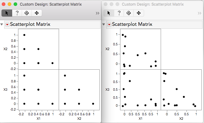

I use the scatter plot matrix to illustrate the coverage of the runs to the various factor level combinations as an experimental design is evaluated. Since I uploaded version 13, I am unable to get the points to jitter. I checked the Points Jittered option within Preferences/Platforms/Scatterplot Matrix and the problem persists. Has anyone noticed this issue and is there a way to rectify the situation?

I changed data type from continuous to ordinal for the purposes of jittering the scatterplot matrix.
Re: Scatterplot Matrix with Points Jittered not working in JMPPRO 13
Thanks for the answer Lou! Such a simple way to get it to work; I should have thought to try it first. This will work out well for helping out team to understand the coverage of runs for varous design plans. I appreciate such a quick response.
