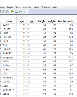

As stated in your previous discussion on this topic, You CANNOT have to formulas defined for a column.  Here is a simple illustration of that using the Big Class data table.  If you define 2 formulas for a column, the second formula will replace the first formula.
new column("two formula", formula(:height), formula(:weight));
Gives the following results
Note that the second formula defined is the one JMP ends up using.
