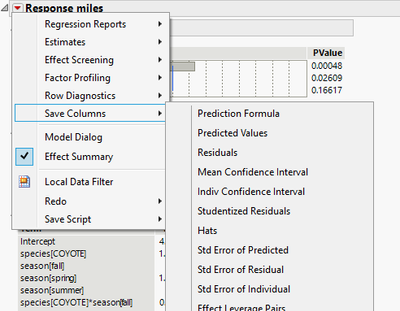

You might have to use different message. Check what options you get from red triangle menu

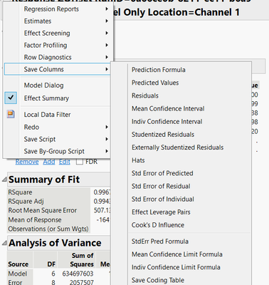

Thank you. I updated the scripto just say "obj << Prediction Formula" and that saved the information to a new column in my data set.  Here is what the options were in my dropdown:
