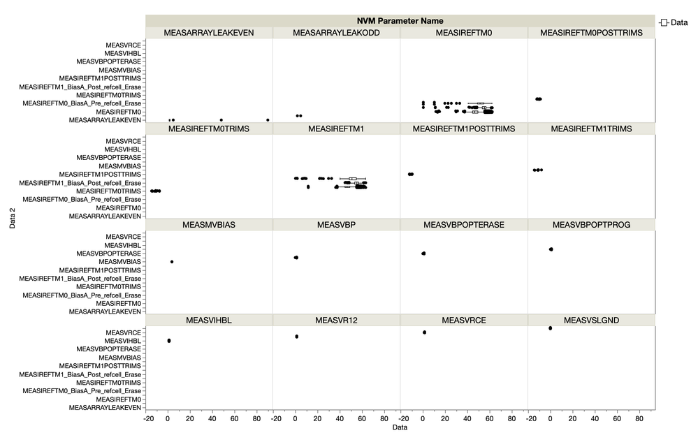

Re: Save two graphs in one slide of presentation
Just a suggestion:
Stack the three Measurements columns and then make this figure in graph builder.
Its all the figures on one slide.
JMP Systems Engineer, Health and Life Sciences (Pharma)
Just a suggestion:
