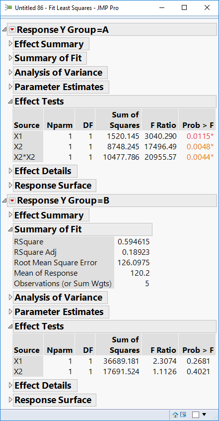

In the second step I will refine the different models for each group:

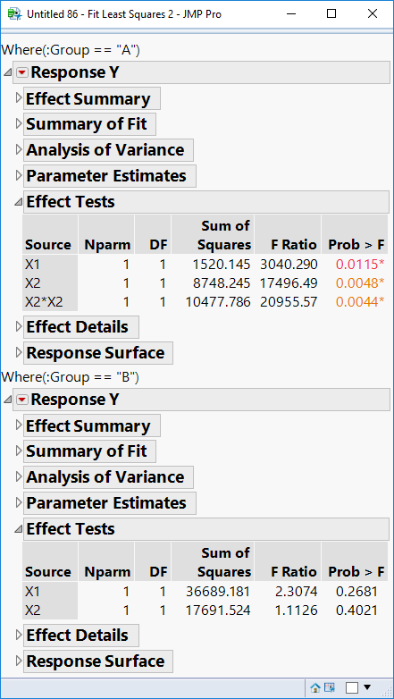

Now I have two models. I would then like to save a script that reproduces this report. Sadly when saving the script using the typical way (Hotspot => Save Script (All Objects) it gives me the following output:
This is problematic because now I cannot righclick into the tables and "Save as Combined Data Table". I'm then missing the "Group"-Information.

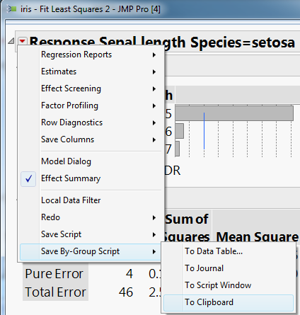

Not sure when this was introduced (which version) but I believe the By-Group script will do what you need:

What JMP does with "To Data Table (All Objects)" when you have a By group is to basically create a separate report for each level of the By group and concatenate them all together within a vertical list box.  ih is right that at least with JMP 13 there is a "Save-By-Group Script" option.

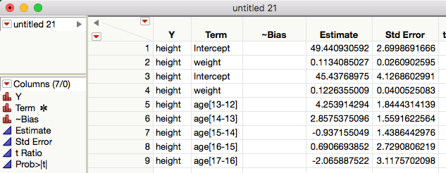

Using 'Big Class', I made:
so one could take the 'Intercept' cell as the indication that this and subsequent rows are for a new level of the 'By' group.
