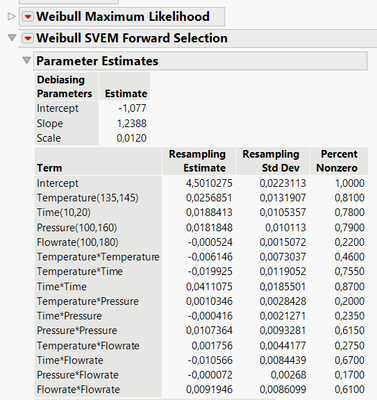

I made a SVEM analysis and would like to use the formula to comupute process control ranges using the Design Space Profiler. I saved the prediction formula and  can't save a prediction formula with process parameters, only a Mean formula here below?
Is  it possible to get an expression as a function of the process parameters that can be used in the design space profiler? Or can I use the Maximum Likelihood expression reported together with SVEM in the GENREG report?

Are you using Generalized Regression to develop the SVEM model?  That platform allows you to save the simplified formula, in version 18 and 19, when you choose "Save Prediction Formula".  What you are using are the resampled prediction formulas, I think.

When I click on red triangle and select save colums in menu  I only see  "Save Resample Formulas"? No simplified prediction formula

The option "Save Prediction Formula" is only available when the specified distribution is Normal: https://www.jmp.com/support/help/en/19.0/#page/jmp/model-fit-options-for-selfvalidated-ensemble-mode...
