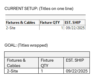

I'm currently using JMP 19 and  want to be able to get the titles / headers of my columns to be a wrapped text in the Data Input Table screen for the Tabulate section I create.
Would someone know a step by step approach?
For example:
Instead of "Hello World" it becomes,
"Hello
World"

You wish to have wrapping somewhere in Tabulate? Could you provide drawn example of what you wish to have?

Maybe a screenshot - indicating what you mean with Data Input Table screen.
the column list on the left?
Re: Step by Step Wrap Text in Tabulate Column Titles
Below is a screenshot of what I would like to achieve within the Demand Input Table - Tabulated window

I had hoped that adding the wrap to the input table would do the trick, but it didn't.
Tabulate seems to prefer single-line headers. Hard to convince!
On the other hand: has an effect on the  vertical axis - somehow:
dt = New Table( "test",
	Add Rows( 5 ),
	Compress File When Saved( 1 ),
	New Column( "Fixtures& Cables",
	New Column( "Fixture QTY",
	New Column( "EST. SHIP",
New column ("value"), Group Columns( "myGroup", :"Fixtures& Cables"n, 3 ) ); //-------try this: ------------- dt = current data table(); cols= dt << get column references; for each({col}, cols, colname = col << get name; col << set name (substitute(colname, " ", "\!n" ))); // .... no change ...... Tabulate( Add Table( Column Table( Analysis Columns( :"Fixtures&Cables"n, :"FixtureQTY"n, :"EST.SHIP"n ) ) ) );
