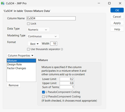

Have you checked that your mixture factors have the right column properties :
  • "Mixture" with low and high individual factors values
  • "Design Role" with role set as Mixture
  • "Factor Changes" set at Easy (or other type if you have a split-plot/restricted randomization scenario)
Here is an example on Donev Mixture Data with factor CuSO4 :
When launching the Profiler from Gaussian Process (or any other ML model), the mixture constraint is respected and enforced (mixture factors always sum up to 1):
(view in My Videos)
Hope this answer may solve your problem,
Victor GUILLER
