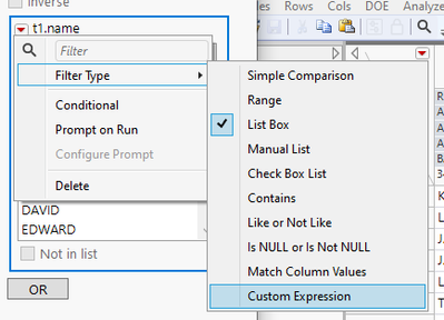

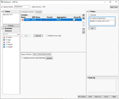

jthi
Re: SQL Query Case Sensitivity Issue
I think you might have to add custom expression to handle situations like that

Arthur
Level II
Got it, that would be similar to referencing SQL statements in open Database function. Thanks!
