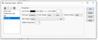

Quickly checking I couldn't find any preference to control that. You might want to create a wish list item for that and it might be implemented at some point.
You can change the color from Customize menu manually (or from legend if you are already using Color zone)

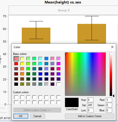

If you use black it seems to be using the default color, so if you want them to be black, use custom color (from Other) and change one of the rgb values to 1
