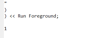

@pmroz I tried the similar thing as above. after custom SQL run, returning the result  is 1 in the end of log. could you please help explain more about the result of 1? is it Eval( Parse( gbStr ) ) return code that you mentioned in your script?

Sorry I don't use Query Builder.  I would guess that the return value of 1 is true indicating success.  But that could be a wild surmise :)
