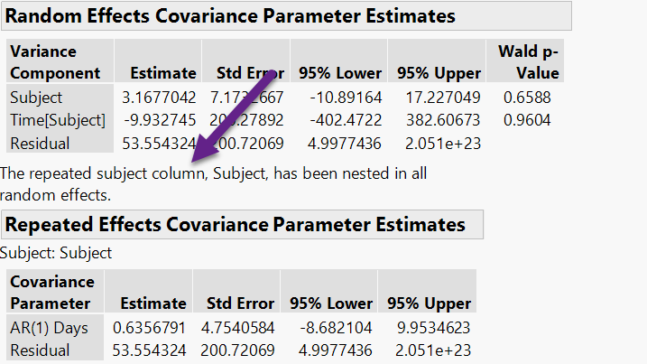

Re: SAS code in JMP?
You can add more than one random effect in the analysis of repeated measures. However you will get a note saying “The repeated subject column has been nested in all random effects.”  See the screenshot below. I think that is why Adam suggested dropping Rep(Year) because it will nest in Treatment.
Have you tried including two random effects? What have you seen?
@jiancao Thank you for your explanation.
Every time I include more than one random effects, I get "0"  for Estimate, Std Error (see scren shot) for one of the random effects. Why would that be? Is it because of the nesting?

jiancao
Staff
Yes, the random effect, Year(Subject), or whatever the first one, is the estimated between subject variation.
