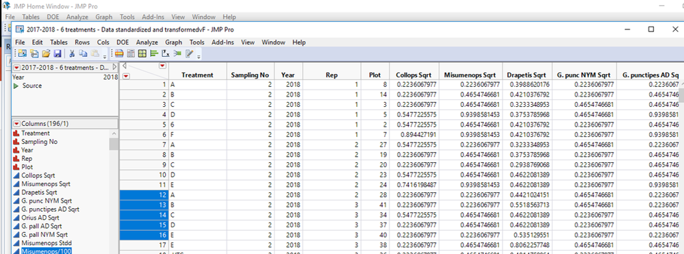

It would be helpful to know a little more about the structure of the data table. What would it look like for one subject? Do repetitions occur within week? You will need JMP Pro to use the AR(1) covariance structure.
bordini
Level III
Re: SAS code in JMP?
Hi @DonMcCormack , I've attached a screen shot of how the data table looks like for each subject.JMP DISCUSSION.png
I have 4 replicates, 6 treatments and 2 years. Samples were collected at 3 different days after treatments were applied. I'm calling these sampling days of Sampling No. in the data table and they're called "week" in the SAS script.
I have JMP Pro 13.
Thank you in advance,
Isadora
