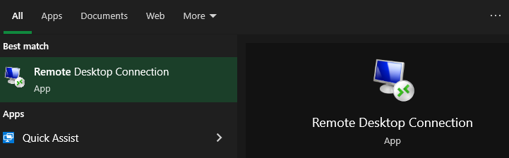

this: https://en.wikipedia.org/wiki/Remote_Desktop_Services ?
It just works. I've used it with remmina on Linux to see a windows host in a Linux window, as well as
RDCRDC
from a windows machine to another windows machine.
You can use RDC to connect to another windows machine. If the machine is a windows server OS, more than one user at a time can connect.
You'll probably need a JMP server license for JMP to run on a server OS. Your JMP support people will know more about how that works, and it may be what you already have. (I'm unfamiliar with Citrix.)

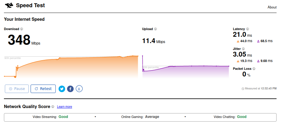

I don't have answers. Is that your internal intranet or external? Is JMP the only sluggish app?
If it is a general issue with most apps and an external network you might try a speed test from both ends. https://speed.cloudflare.com/ is my new favorite:
The latency numbers might tell you something. (Be sure to scroll down.) You might get really different numbers running it on your local browser vs on a browser on the Remote Desktop Server. I would not expect the JMP version to have much to do with the answer.
