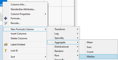

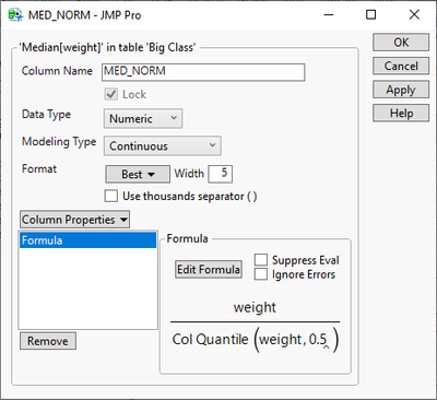

Col Median() gets you median of a column. One fairly easy way to create the column is to use New Formula Column shortcut
First create only Median column and then edit the column properties (name, formula format) to fit your needs
